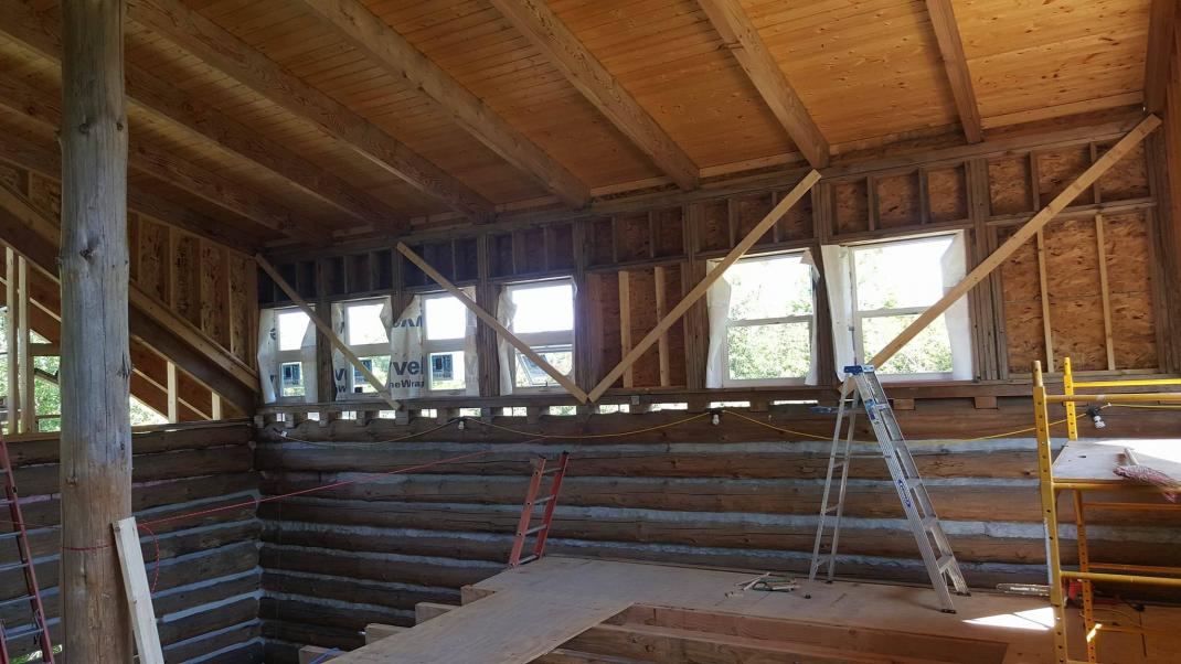

    will find a pic of north small enough to upload here.

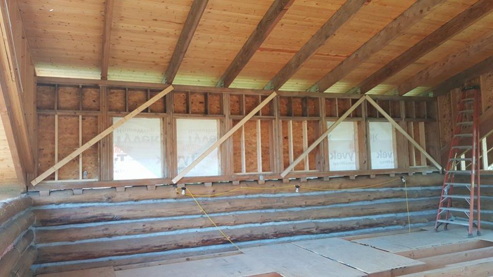

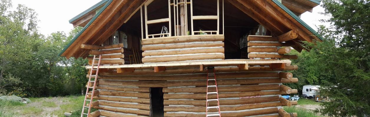

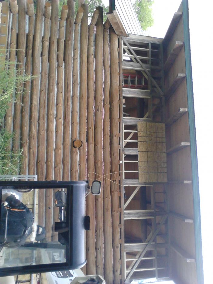

  2. cabin west side
    we finished framing in the west side gable end and started placing OSB, but the month is almost over and we didn't finish our to-do list.
    so we're renting the tele for Sept too.
    here's what we got done: chinking (chinking is done!!!), north and south dormers got framed, bird blocks in, OSB and tyvek on, windows in.
    on the west side gable end, finished framing and started OSB
    here's what we still have to do: west side OSB to complete, west side ...

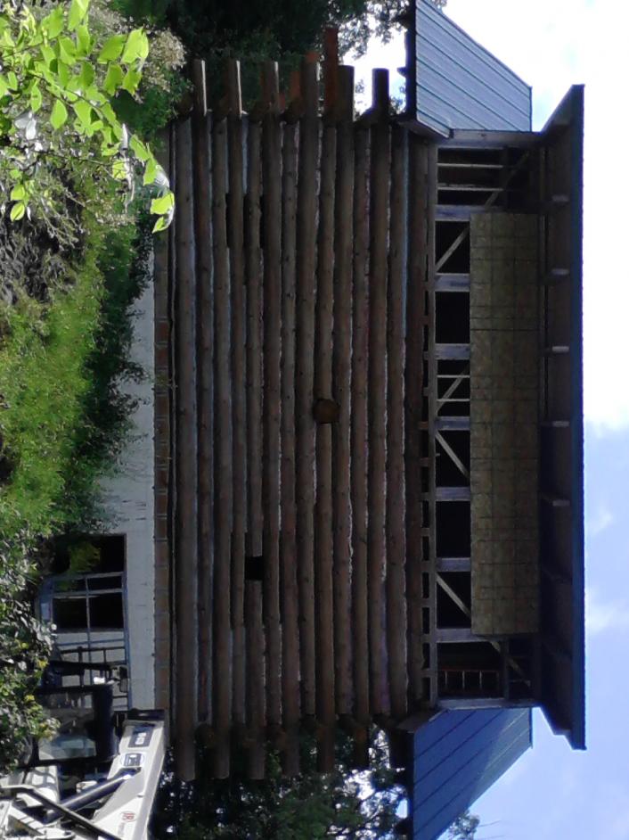

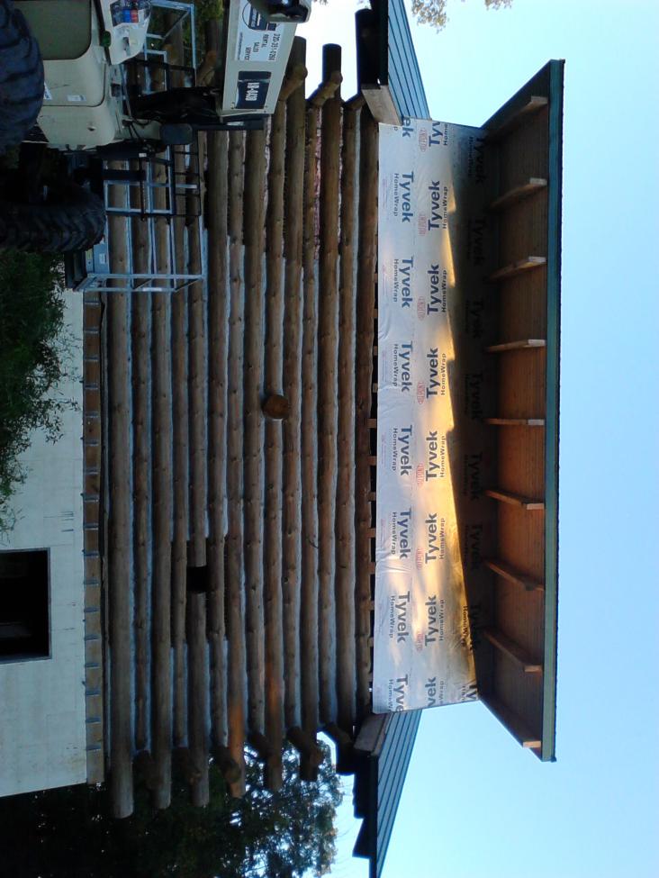

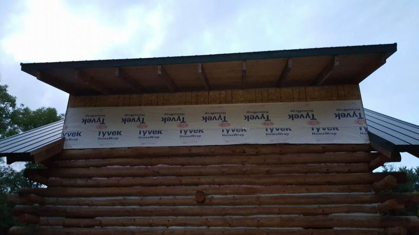

  3. Cabin north side
    on the cabin north side we got the framing done, bird blocks done, osb done, tyvek done and windows in

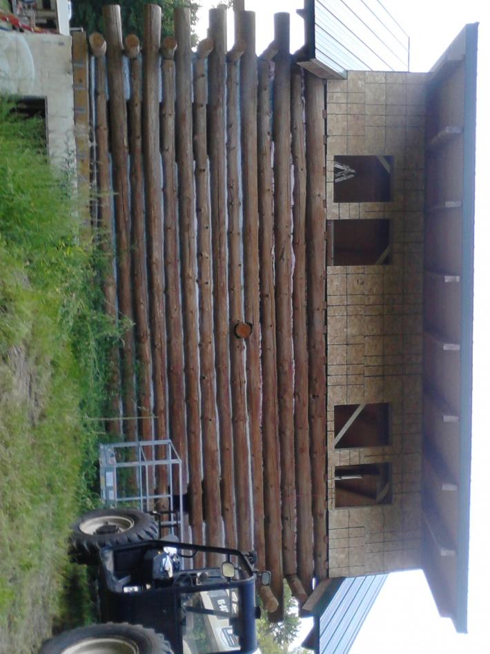

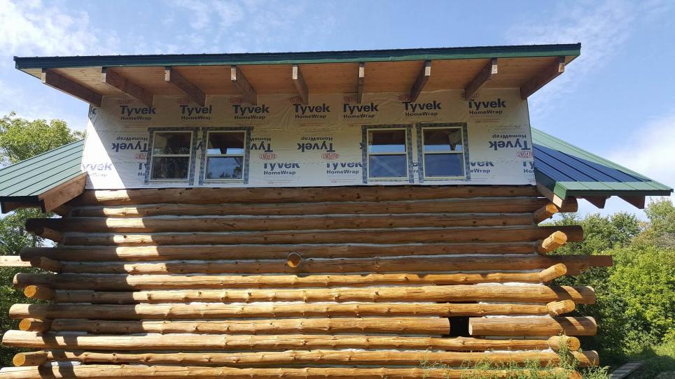

  4. cabin south side
    well on the south side of the cabin we got the dormers framed in, bird blocks in, OSB on, tyvek on
