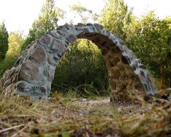

    Heh heh, that mysterious arch reminds me of an arch I built from local stone, in a semi-remote section of a county park near me. It's not dry stacked, but it will make the occasional hiker wonder about it's origin.
