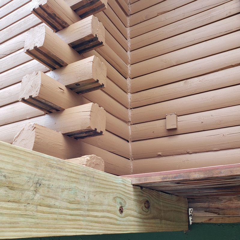

    First of all, we got a second quote that was much more reasonable so we'll probably go with that.
    But, let's see if this works:
    This picture is from under the deck. The chimney goes up about 12'
    I hope that helps.

    yup. I would say foundational support if it's a rock chimney. If it's just chimney pipe, you still need to support it: https://inspectapedia.com/chimneys/C...cing_Metal.php
    that page also has photos of rock/brick chimneys.
    Don't mess around with chimney code- follow it exactly. I don't know which is worse - electrical or chimney fires, but they'll both burn your house down.
    Good luck with it!

    My best guess is, if it's something you think you might be able to tackle yourself, you probably can. You should try to save as many logs as you can, you'll need some to fill the void and you may find other sections of house that need replaced later.
